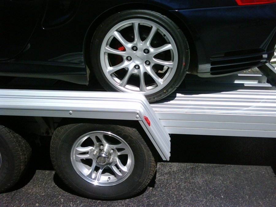

Bizarre... every rear engined Porsche in UK is reversed on, even if you look at http://www.brianjames.co.uk/ one of the biggest trailer sellers around (Europe) their Catalogue pics have a 996 Turbo reversing on... Now what I have noticed is that some of the US trailers have their axles offset back from the load platform which would help with loading nose first... I have always reversed on, you get less tail happy and it's more balanced.... also some of the more modern trailers don't really start to feel balanced until they get to about 60mph, I purchased this http://www.brianjames.co.uk/pages/trailers/himax.html and tow it with either X5 or Merc Vito and it's just great, so good that I have looked at the speedo and once or twice noticed that I am heading towards 90mph mark (I do stick around 70-75mph). Also remember if you feel it starting to snake and get tail happy do not try to correct it by braking or steering, just drive through it but don't accelerate like some say, this is can also make matters worse, once trailer is back under control then start to slow.

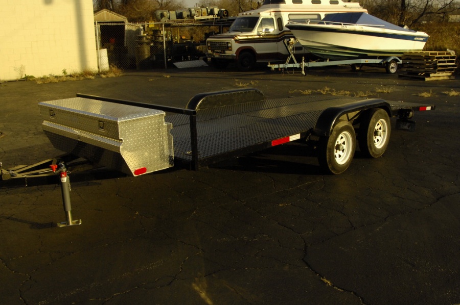

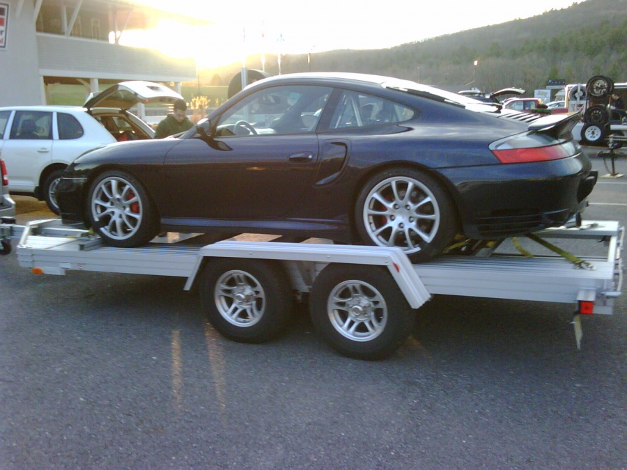

I use a trailex for my turbo and tow with a mid sized truck. no problem going 80 if I needed to. Balance is the key. The rear wheel axle of the car is about 6-8 inches behind the rear trailer axle and that seems to work well for me.

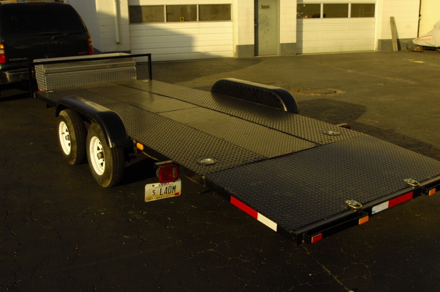

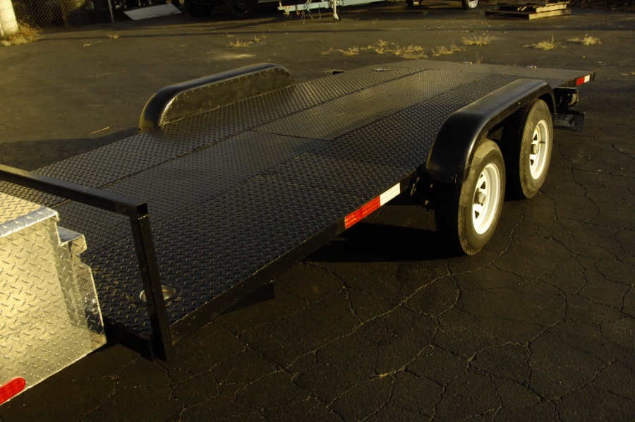

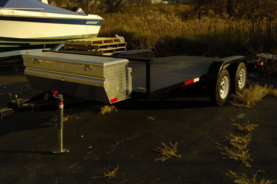

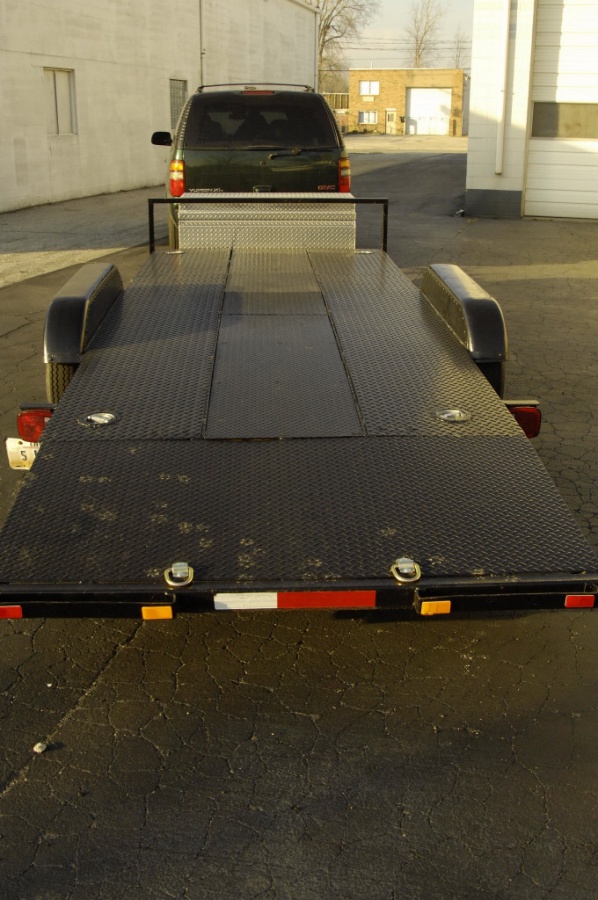

viprkilr...i just saw your aerial photo of your trailer. Tough to tell exactly without measuring but it looks like you may need to upgrade to a new trailer in the future as the trailer axles look to be about midway on the trailer. With the tool box in front, my guess is that you definitely have too much weight hanging off the rear and not enuf tongue weight. I guess you can try removing the tool box and seeing how far forward on the trailer you can go. I posted some pix of my car on my trailer FYI.

I put the car on the trailer today & moved as far forward as I dared. I disconnected the trailer from the hitch & estimate the tongue weight around 200 pounds. From the earlier posts, this is just too little weight. I am going to talk to a hitch establishment in town this weekend to see how to go about moving the axles farther back or extending the trailer forward a bit. I appreciate all of the advice. I won't use the trailer until I have it "dialed in" correctly. It scared the absolute pee pee out of me when the trailer felt like it was literally yanking my 7000 pound Yukon sideways.

So, you do realize this is gonna be a chunk of change, right? They're going to have to relocate the fenders, along with the axles, and if you have a "flex" spring setup, they're gonna have to relocate those mount points as well. Lot of welding you're talking about... And you don't have a good baseline for where the car needs to sit on the trailer. They'll be guessing, at best.
Do yourself a favor and remove that toolbox and then reload the car on it and bring it forward further. It'll overhang past the front lip on the front of the trailer. That tool box is the issue.
