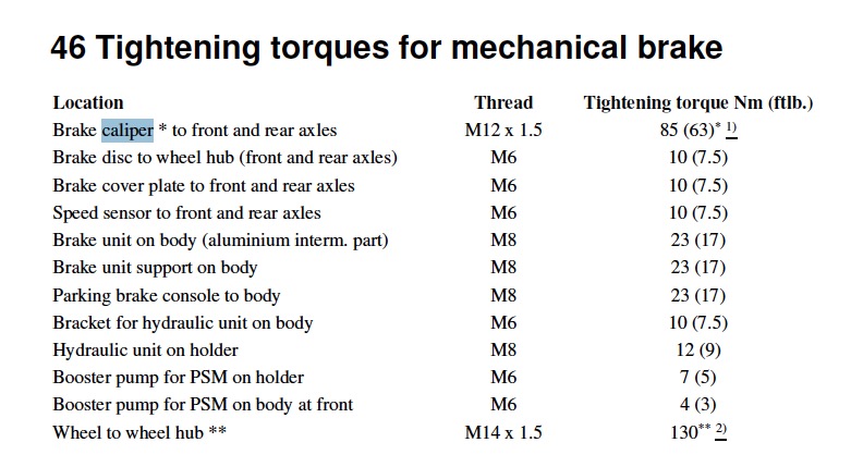

Originally Posted by Ck986
Wow that's low I was expecting at least 100 for the fronts. My Touareg calipers need 200lbs up front.
Thanks
I've work on GTi lately and in fact the torque was 200 ft/lb ???? I was really surprised!!!

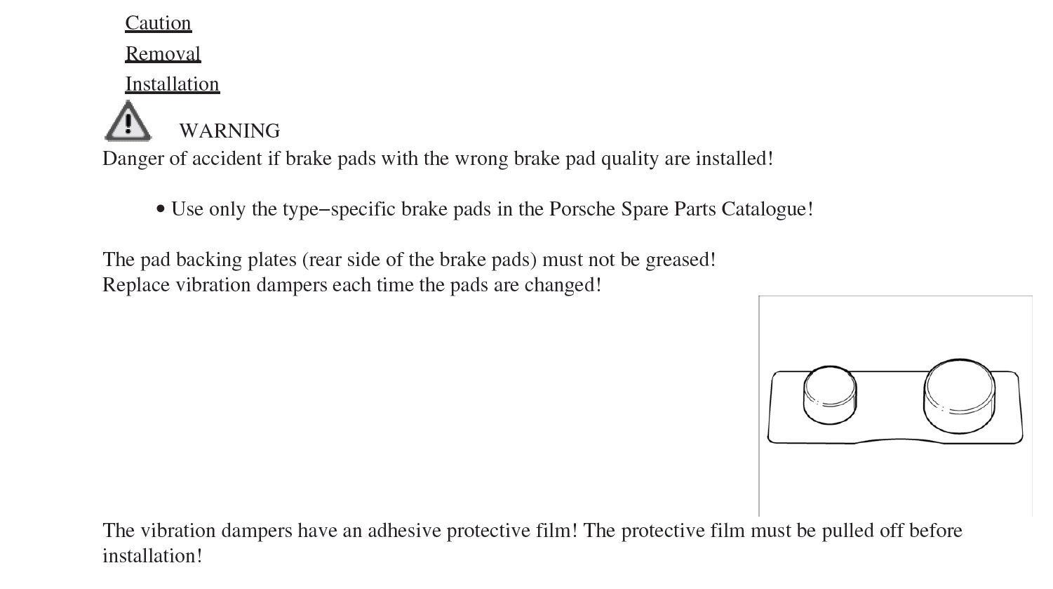

Raising a thread from the dead, smistry007 great write up, just wondering why you didn't mention anything about putting the front pad vibration dampers back in? Did you not put them back in?
And the rear pad spiders, which I assume do the same thing as the front pad vibration dampers, is this where you would normally apply brake pad grease to help them stick or is brake pad grease for something entirely different?

When I don't have the answer, and this happen often, instead of guessing I just give other people the chance to answer....Remember we do that voluntarily, just to help other TT owners because we respect them!
I remember a Porsche a note mentioning not to use any grease on bake pad. I do not replace the damper every single time but with a knife I gently take them off and just put them back in and the glue left on them eventually, with heat, stick back on the pad......
I think I'm getting old
