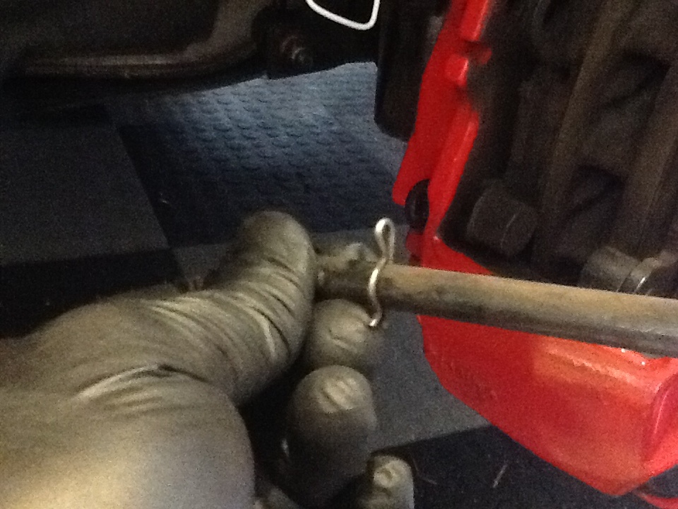

I used this yesterday, very helpful. The clip on step 3 is tough to see but easily removed. All in all about 20 mins a side
A friend of mine reminded me to paint the center of rotor with high temp black. Keeps it look nice over time
