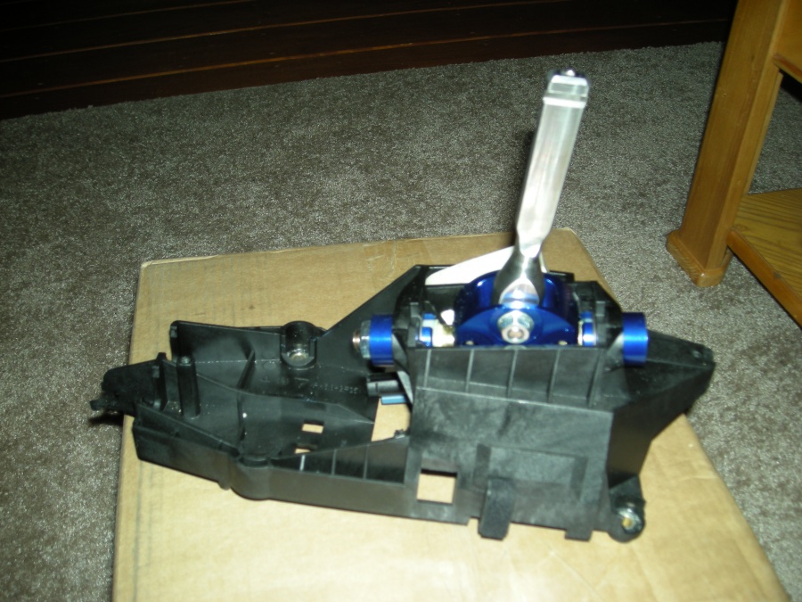

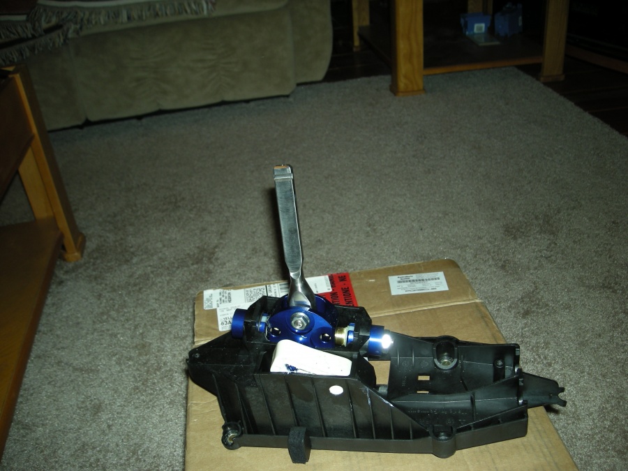

Old Jan 23, 2010 | 05:39 AM
  #27
ttboost's Avatar
Joined: Jul 2008
Posts: 6,453
From: CT
Rep Power: 439
Originally Posted by John@SpeedTech
Thanks, Mike. The reason I am interested is that you mentioned this to me last year and I have been on the fence ever since. I think I am going to try it based on all the positive comments. If you remove the B&M, can you re-install it later, if you prefer it or are some of the parts ruined when you take it out?
If you buy a brand new 997 shifter it will come with everything (which really is just the alignment tool). After you remove the console (20minutes?), you remove the cables and there are 4 nuts to remove old shifter "cage" and you use the same 4 nuts to install the new shifter "cage". This is my old B&M setup. The new shifter replaces ALL of this.
Old Jan 23, 2010 | 09:32 AM
