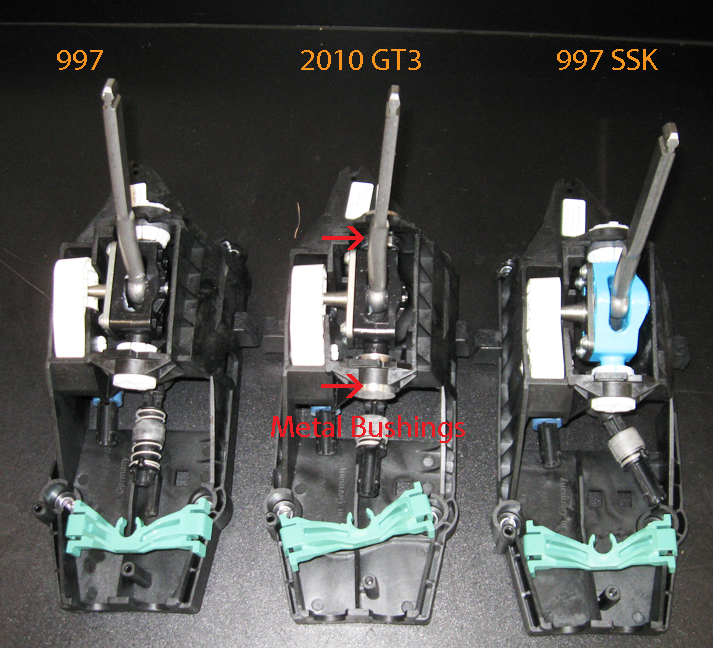

OK, now that I got that out of the way, could you guys please help me to evaluate the following options for my 2001 996TT please? I'm determined to stick with an OEM solution rather than go to the B&M, but that is mostly because I like the clean and plug/play nature of the entire assembly (not to mention the fact that it's a factory part...fine by me).
So, I have the stock 996TT shifter and obviously it has fairly long throws. My concern is that if I get something too short that I might start rushing shifts a bit too much and cause some premature wear on the transmission synchros. Obviously, I can control that to some degree...and will. My options are:
1. 997 shifter (seems like the most well rounded bet...good price too)
2. 997 GT3 shifter (aluminum bushings instead of plastic, will I even notice? Considerably higher price)
3. 996 short shifter (unsure about this one, more expensive than the other options, and I believe this is the same as the B&M shifter, correct?)
Please let me know if there are any other factory options I'm overlooking. I'm unclear about the 997.2 GT3 shifter or 997 GT2 shifter...meaning I don't know if those are even different part numbers from others listed above. Since I only want to do this mod one time, the more feedback the better. My car is not a daily driver but is more of a weekend driver. I don't take it to the track either, in case that comes into play. Thanks all.

Here is a picture of the 3 assemblies side-by-side, graciously provided to me by Ric of Suncoast Porsche.

The 997 stock shifter in the 996 is a great compromise.

I have the 997 SSK in mine & it feels like butter.... It's perfect for me,short & alittle notchy at first but smooths out after some use.

I had a B&M in my Turbo & it to felt alittle notchy. The 997 SSK is not as notchy as the B&M,not sure about differences between the 996 SSK & 997 SSK.

Clarifying question though, isn't the B&M the same as the 996 SSK? I've noticed a few folks over time have moved away from the B&M so I want to make sure that the 996 SSK and 997 SSK are indeed completely different shifters (if possible).

Yes, diff. part # & shifter betw. 996 SSK vs 997 SSK. i recently swapped out my tequipment 996 SSK to 997 SSK. Finally happy because 997 SSK is now much more precise, not notchy, & smoother shifts. My advice get 997SSK over the regular 997 shiftkit, because you'll always wonder how it feels to get the new smoother shifts while being short at same time.

I have the OEM short shifter in my 996 Turbo and I think it's pretty good. It's very smooth and the throws are much better than stock. There are definitely shorter throw options, but nothing that's a smooth as the OEM one. It all depends whether you want smooth or are ok with notchy.
