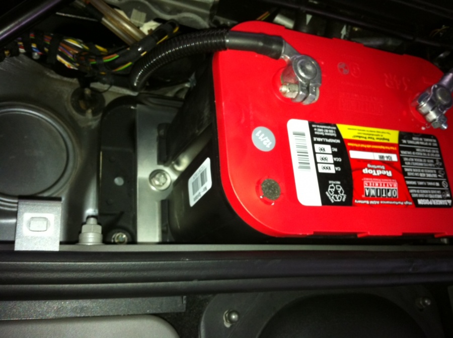

Optima 34R
My battery acid spilled out and messed up the battery tray. Luckily that was all.
I have been seen some yellow stains on my driveway and under the car for some times and I could not figure out what they were. They are Battery acid overflows.
I took out the battery plate, clean/sand/spary paint it. The battery tray nuts were kind of mess up too. I bought some 8 mm stainless nuts and washers to secured battery tray to the car.
I did some research and found a battery adapter plate for Optima 34 R (no more battery acid issue). It was mad by yellow dog. I did have to buy a 15 (12" better fit) battery connector to replace the negative end becasue the stock one was too short. the stock positive works but I had to loosen to turn it up a bit.
The car started right up.
