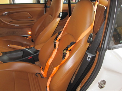

I'm sure it's been proven and I hope not to find out. I know it's a close match if not exact replica of the Porsche factory bar that's no longer available. It bolts right up to where your seat belt bolts/mount. A welded in bar would be better as would a full race cage but this is a quick and efficient fix on a budget.

Yes, welding is obviously preferable but that requires mods that cannot be easily undone and carpet cutting as well. Plates have to be welded to backup the sheetmetal when you weld or in the end they will "blow through the bottom" as easily as a poorly bolted in cage too. This bar is bolting to the seat belt bolts and whatnot - those are going to be about the sturdiest points you can use as they are already reinforced for obvious reasons. Is it as good as being welded? Of course not! But in a rollover situation this bar could be what keeps the roof up if it's got support to keep it from folding forward or back which this one appears to have. Porsche likely stopped selling theirs due to a lawsuit - maybe someone smacking their head on it. Certainly bars can make a car MORE dangerous if there's someplace your head might hit it and no way in heck would I ever put someone back there. Pad the thing with SFI rated padding and it would be better just know that SFI padding tests assume a helmet is being used, it will still ring your bell if you hit it - guess how I know! The padding was the difference between a bloody mess and a headache though so DO pad any areas that cuold strike you or a passenger. The bar likely does improve rigidity some since it ties in multiple reinforced points but make sure the mounting bolts stay tight or you could end up tearing up the mounts if it moves.
Honestly this is something I'd consider since no one is going to be sitting in my back seat - it's better than nothing...

Never ever put someone in the back if you have a bar/cage installed. Had a cage in my GT3 but never installed the front section as I drove more on the street (no helmet : ) ) than on the track. In the event of an accident and hitting your head on the bars with padding or without is going to crack open your head!
