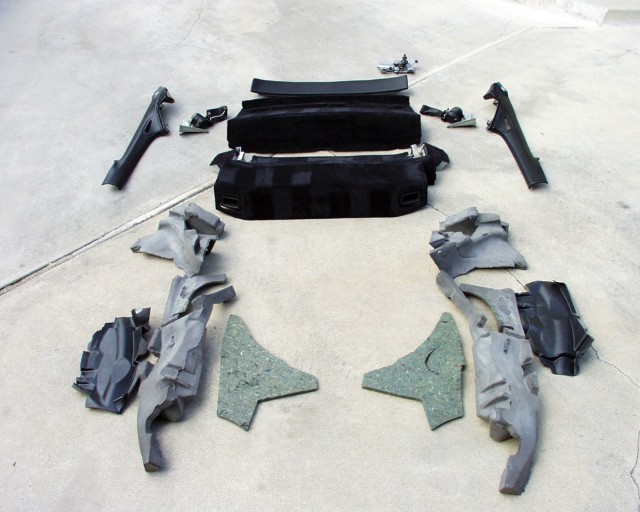

Other Interior:
-Subwoofer Removal - 12.2 lbs (Al Norton)
-AC condensers, compresser 22.1 lbs (Al Norton)
-Door Speakers 18 lbs (pair) (Al Norton)
-Dash/Rear Speakers (1.5 lbs each) (Al Norton)
-Sunroof - TBD (Tom Kerr)
-All interior Carpet and Seatbelts TBD (Tom Kerr)
-Passenger front air bag removal 10lbs (Tom Kerr)
-Side Air Bags 5 lbs (One Love)
-Complete Interior Carpet approximately 52 lbs
-Shaved Interior Carpet 11 lbs

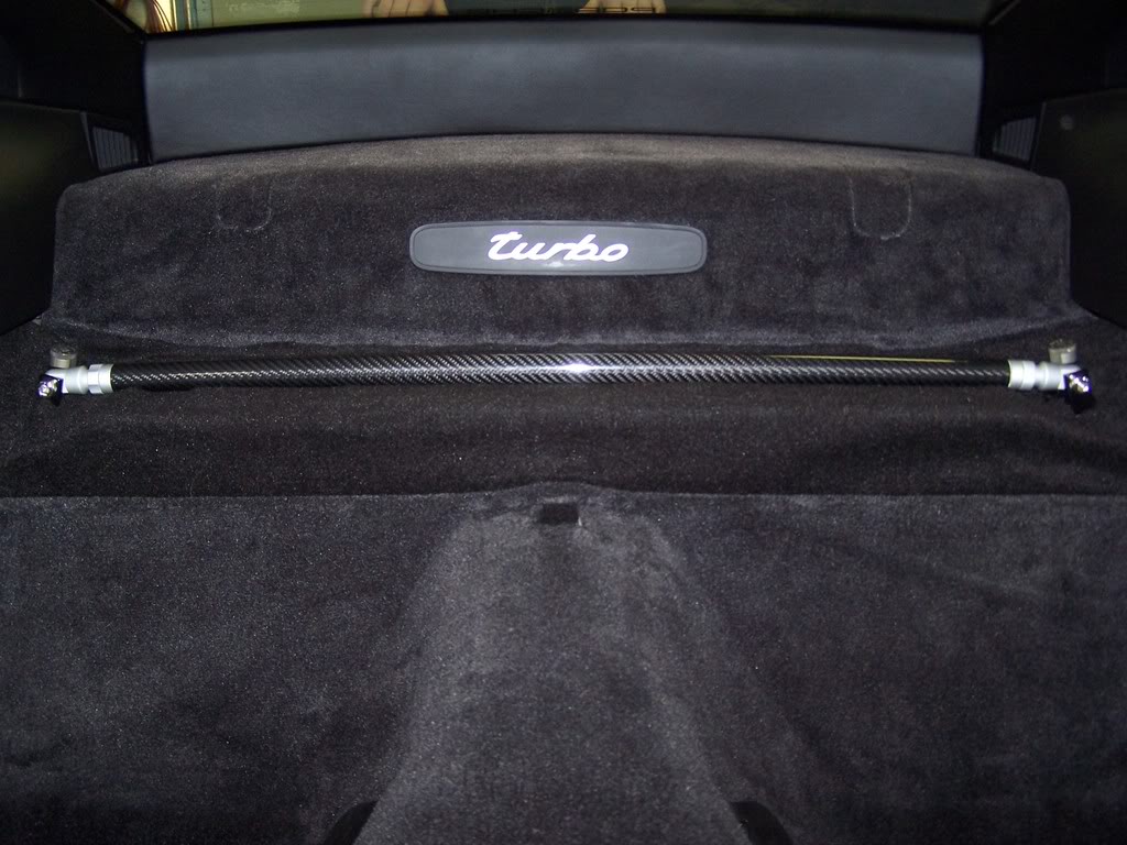

Lightest Turbo List:
Stock- 3495 lbs
Weights included are with 1/4 tank of gas averaged in or used on the scale.

-Removed rear seats,seat belts, hardware and foam rubber insulation

From pg 17
Originally Posted by oak
I didn't get a chance to weigh all this stuff I removed,... I think it's more than 38lbs. didnt' seem that heavy while removing individual items but once everything was removed it seemed to weigh much more than 38lbs.
Originally Posted by silvershark
I removed the same things, in addition I removed the foam rubber insulation
over the fenders. 38lb savings
OAK...here are some pics of the carpet pad delete.
