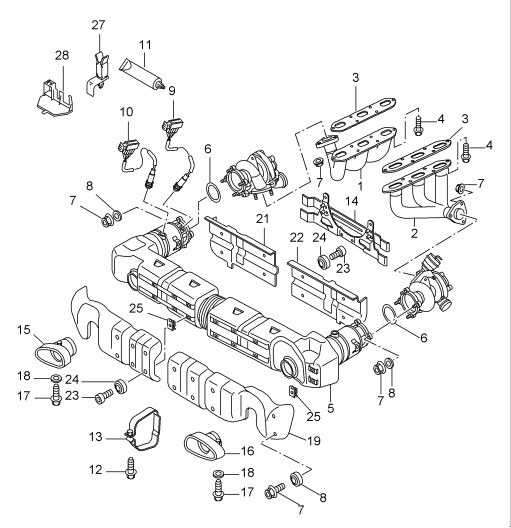

Anyone know the bung thread size for the O2 sensors? I am having difficulty finding the thread size. Thank you.

I am not looking for an O2 sensor, I'm looking for the thread definition for the bung. Thanks.
Porsche does not seel the thread... Below is the diagram so you see how they have it broken down.

Originally Posted by bmiller33
anyone know the bung thread size for the o2 sensors? I am having difficulty finding the thread size. Thank you.
M18 x 1.5
