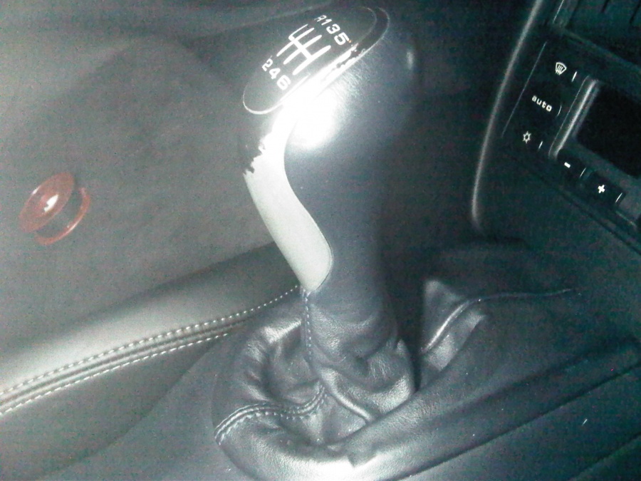

I have a 996t and i wanted the alcantara gt3 shifter and boot in my car. The 996 and 997 shift boots are obviously very different shapes. The 996 is more of a narrow oval i guess you would say and the 997 is more of a square. The shift **** from the 996 detaches from the boot with no problem. So here's what I did....
I loosened up my **** (haha), the old shift boot, and snapped out the piece of plastic it attaches to out of my car. Then removed the boot from the **** (very easy). I then just put the **** back on the shift kit with the kit exposed so i could drive my car in the mean time. I took my new 997 gt3 shifter and old 996 shift boot and piece of plastic to my local interior place (it happens to be a very legit one). I had them match the alcantara color of the gt3 **** as close as possible and sew me a boot that would fit in the 996. They cut the boot off of the 997 gt3 shifter and sewed on the new alcantara one they made in the 996 shape and fit it to the 996 peice of plastic (which i also had them paint black and it looks so much better). I had them do the stitching in red to match my seatbelts. And the car is a little dirty so there's some white flakes that wouldn't normally be there...Here's a picture for you guys....

How much did it cost?

Harker,
It was $300 (cash price) plus the cost of the gt3 shifter obviously. It's definitely expensive but the work was on point. The interior guy actually brought me back into the workshop and we looked at pieces of suede he had left over from past jobs. He was willing to give me one of these for free which was cool of him and would have saved me 160 bucks or so (cant remember the exact cost of the material). Unfortunately, there wasn't a piece that matched close enough. A big part of the cost was the 'minimum order' yard of alcantara I had to buy.

ah thanks for the info.
It is expensive but your shifter looks really good.
Thanks man. I like how it came out. There was something about the leather boot and that big golf driver look of the carbon fiber shifter I really didn't like. Nothing crazy but I wanted to do a couple other interior things also. I think in the next couple of weeks I'm going to order the ma-carbon 'ac horse shoe non nav' piece, the 'instrument cluster' and also the 'mid dash airbag strip.' I really don't like the silver pieces my car came with. http://www.macarbon.com/store/996-da...roof-trim-118/
