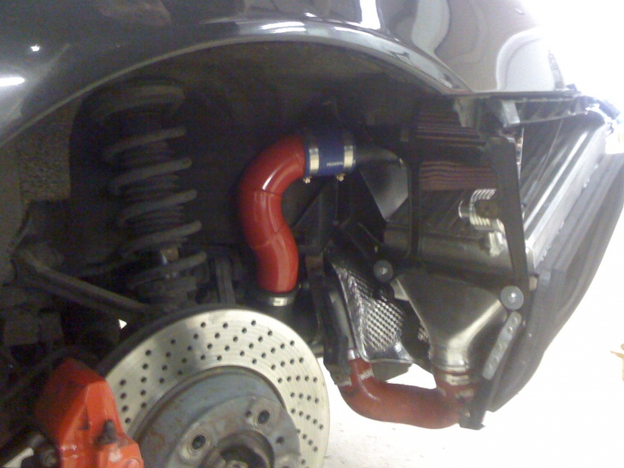

Here are some more pictures - so very close now.
