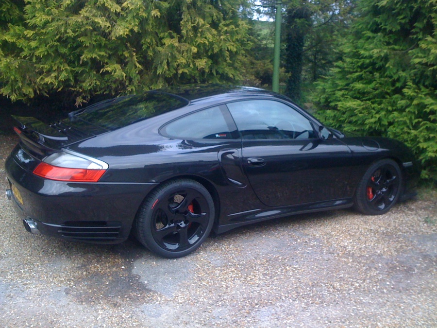

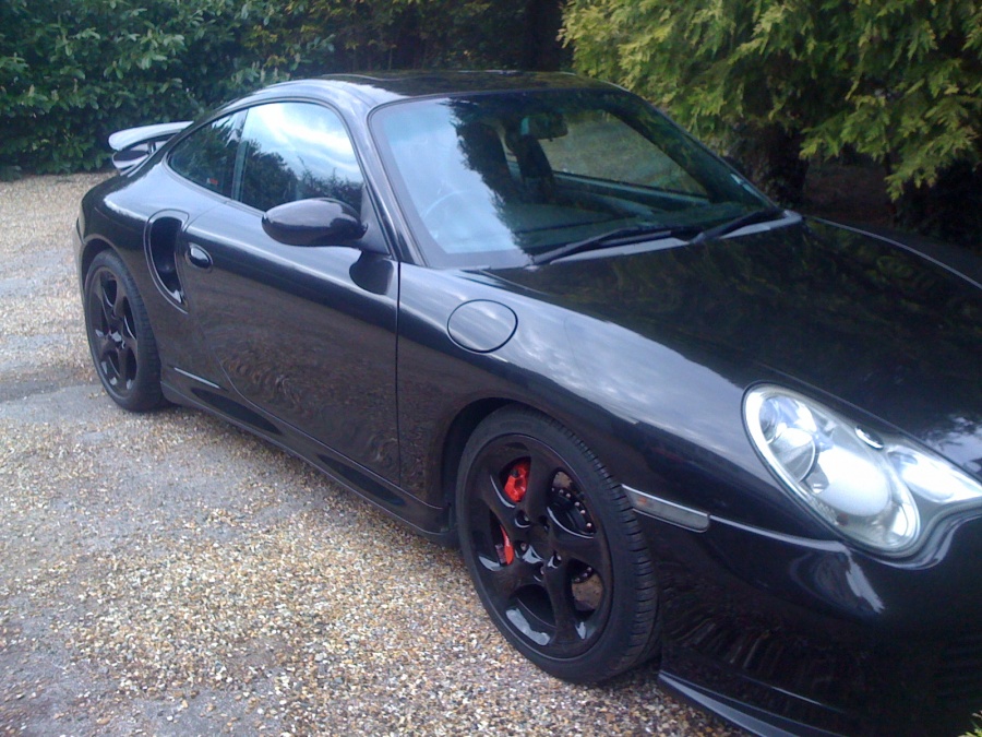

Well the wait is over at last and I have had the car for 4 days now.
Was it worth it? Definitely. There is no doubt in my mind that I made the right choice with the set up and the 20g are just great.
I have run the car up to 1.4bar at the moment, without any gain, or set boost. A mixture of results, since I have the new upgraded gearbox in from MKB (I am not too keen on busting it too hard at the moment).
Tiptronic times
1st - 2nd 0-60 3.6 secs.
2nd gear start 0-100 6.6 secs (okay I did brake boost that one!)
2nd gear start 1/4mile (not at a drag strip) trapped 129.6mph @ 12.6 secs - well there was a lot of gravel to start with, and my 0-30 was 3 seconds!
2-3 gear 60-100 3.12 best to date
So I presume if I do a proper 1/4 mile that I should probably get in the 10s? at 135 or so?
Couple of questions
1) For those that have done 60-130 in less than 7 seconds, do you have a graph (or point me in the right direction) that shows what the time was for the 60-100 part.
2) What speed did you start with?
3) If you have a tiptronic, what has been your experience in terms of the best way to get these times (Do you always use D or M).
4) When you do your times, do you switch PSM off? Does that make a difference in times?
So am I happy, totally!

Congrats the car looks fantastic! Question why did you run the 0 to 100 and quarter mile in 2nd gear?
