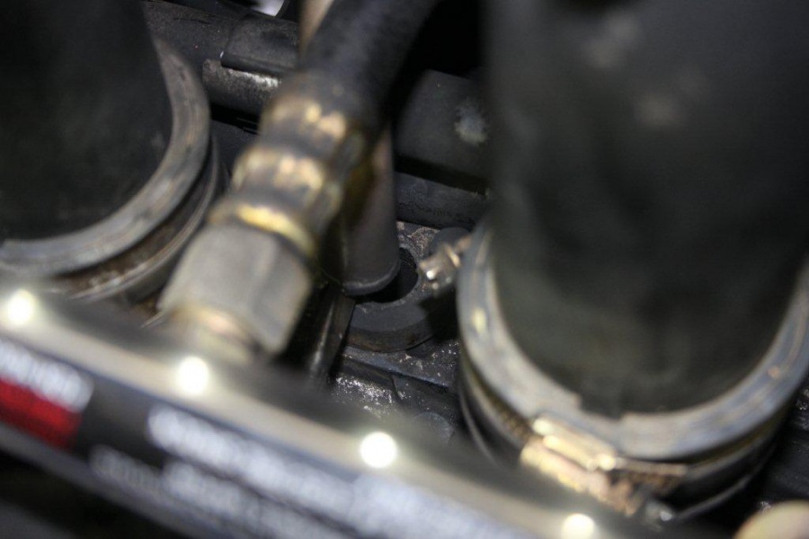

Some photos are attached. From left to right:
Hole where leaking clutch slave was removed. The new slave was installed in front of where it is now by drilling the bell housing. Other hole was covered.
Look up inside empty engine compartment. Notice exhaust trails on drivers' side. These came from broken air pump line, shown below.
Leaking oil line under throttle body
Broken air pump line
Continued in the next post...

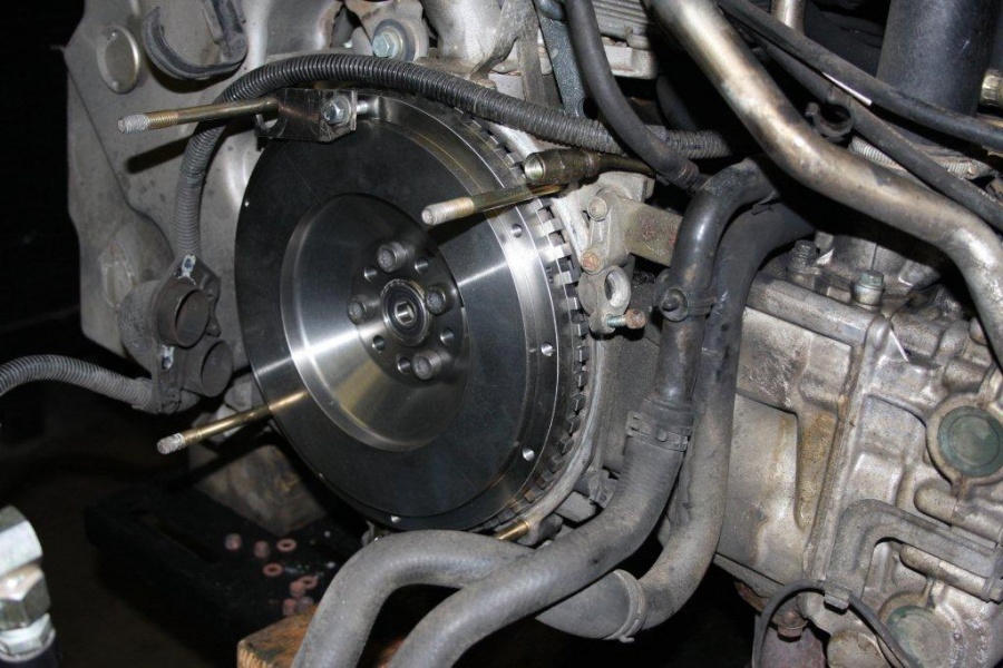

A couple more photos, showing the 964 RS flywheel and one of the turbos. The black coupling steps down from the inlet to the stock air intake. I opted not to get the upgraded larger diameter inlet pipe.
On to the first impressions... I can only talk about the clutch and drivability, because I am following Kevin's strict "No Boost" break-in guidelines. At this point, I have the stock ECU program. Kevin will be sending some new files later.
The clutch is very stiff, but other than that, it's great. Very precise engagement point close to the floor. The 997 SSK shifts "like butta" compared to the B&M Notchmaster that it replaced. The flywheel makes some noise with the clutch out in neutral. Sounds a bit like a diesel truck, but I don't find it really intrusive. Goes away with the clutch in. There is no lumpy idle associated with this flywheel - none - and this is with the stock ECU.
