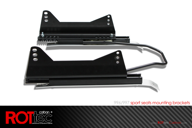

Seat + Harness
OK so I now understand I MUST get the seats - Has anyone tried this brackets with the ROTEC seats? OR do I need any other bar or mount to get the harness mounted? Thanks again to everyone for the info.
Yes, you need another bar to get the anti-sub strap mounted. Your earlier link showed the BK part, I think. It's a cross member that goes between the seat rails shown in your last post. I have the Porsche part: 996-521-933-90
which runs around $65-80 depending on where you buy it.
