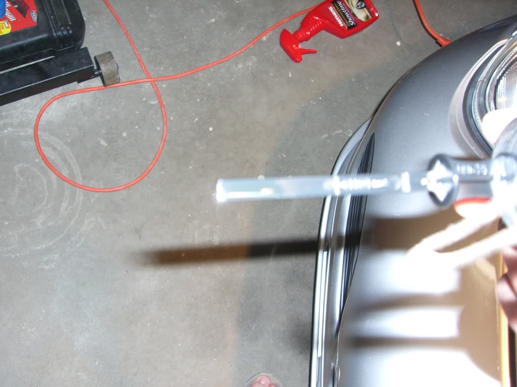

Thanks for the quick replies!
The motor is still warm (got done driving it half an hour ago), so I ran out to the garage and checked the pentosin level. It is currently at the low mark, and halfway to the high mark... if I'm reading it correctly. Here's a crappy pic showing the side marked high and max:

MBailey, if there a dipstick for the front diff? I may have completely missed it, but I couldn't find where to check the level.

you have to have the car running and warmed up... then check the dipstick...
should be on the HOt high level....

I'll check again tomorrow and report back.
Thank you for potentially saving me a trip to the dealership, Markski!
