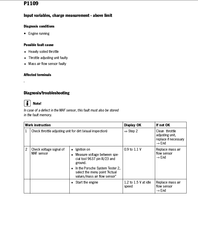

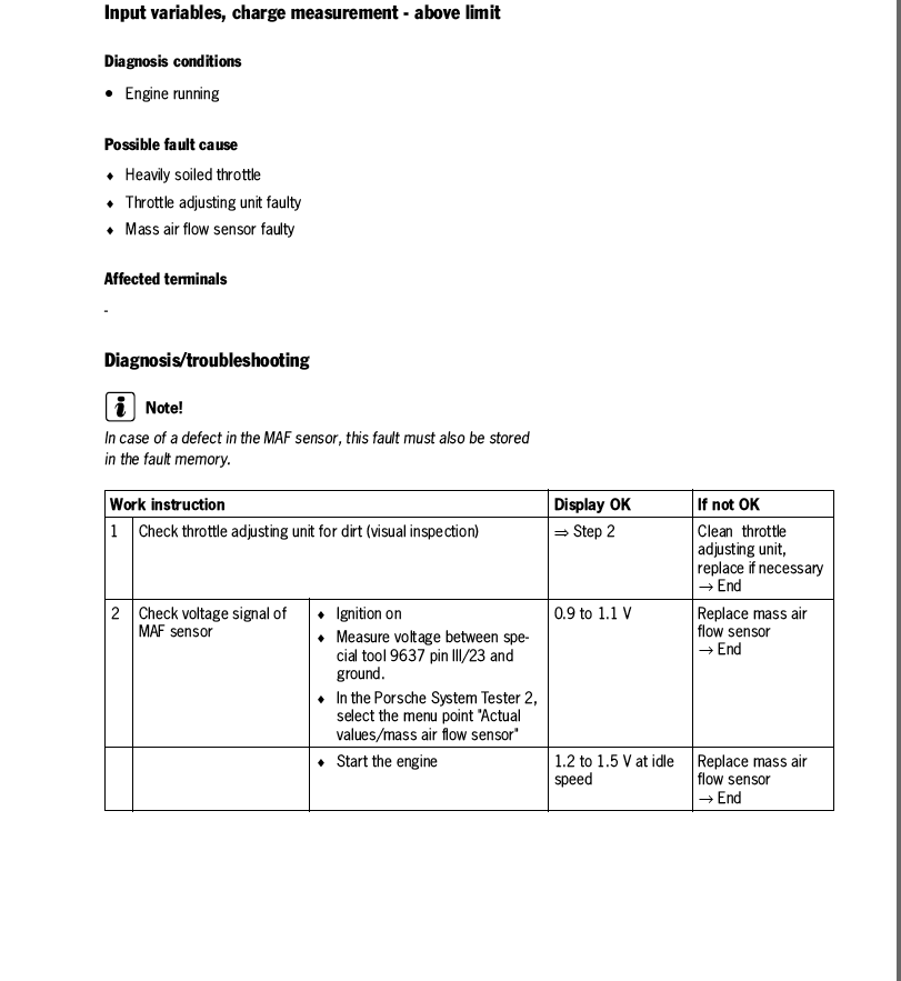

May be....
Ard is more reliable for troubleshooting a modified car but if your car was not modified here is what to look for...

I had this same code and it ended up being a boost leak

I did. Most the problems discussed in there had to do with a boost leak (don't have) or a MAF (sincerely doubt it's that, as the hitachi is brand new as of 2-3 months ago. I did clean the maf anyway, drove it, no code. But usually with my car a code won't pop back up until the next drive cycle.
