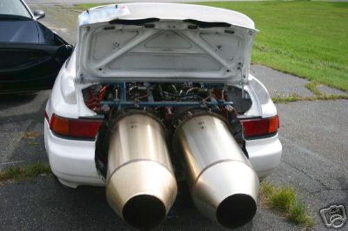

I got exactly what you need Steve... Adrenalin rush guaranteed....Can also be used as a barbecue + it's already on a white car!!!!!
