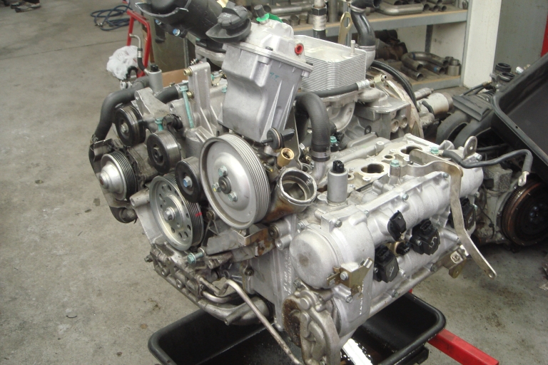

My motor is back together. Should be back in the car and ready for break-in next week. The only problem that was found were the intake lifters; all of them were bad. Mike replaced them with superceded part numbers, so hopefully this will never happen again.
So, in summary; I replaced all of the intake lifters, installed new Pauter rods...and that's it. The most simple engine build ever.

Here are some pics of the completed motor and new Pauter rods.
