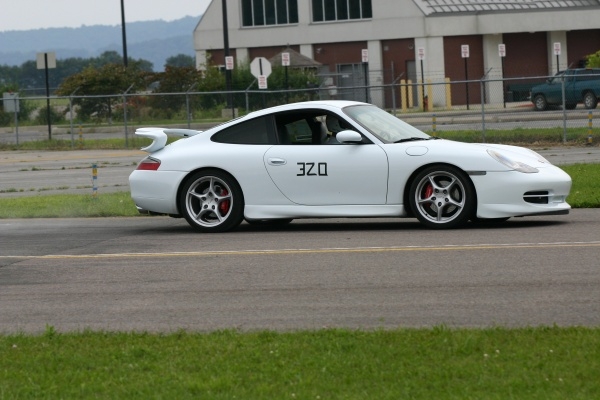

I have the PSS9's and AutoX the car hard. Occasionally lift a front wheel on hard fast turns only. I don't see how you could ever hit your bumpstops at high speed. I run 150+ regularly with no problems.
If you are a track junkie and you have plenty of cash to spare the JRZ are better, that being said, the Bilsteins are a close second everywhere else and cost 1/3!
Here's pic of my car lowered to GT3 specs
