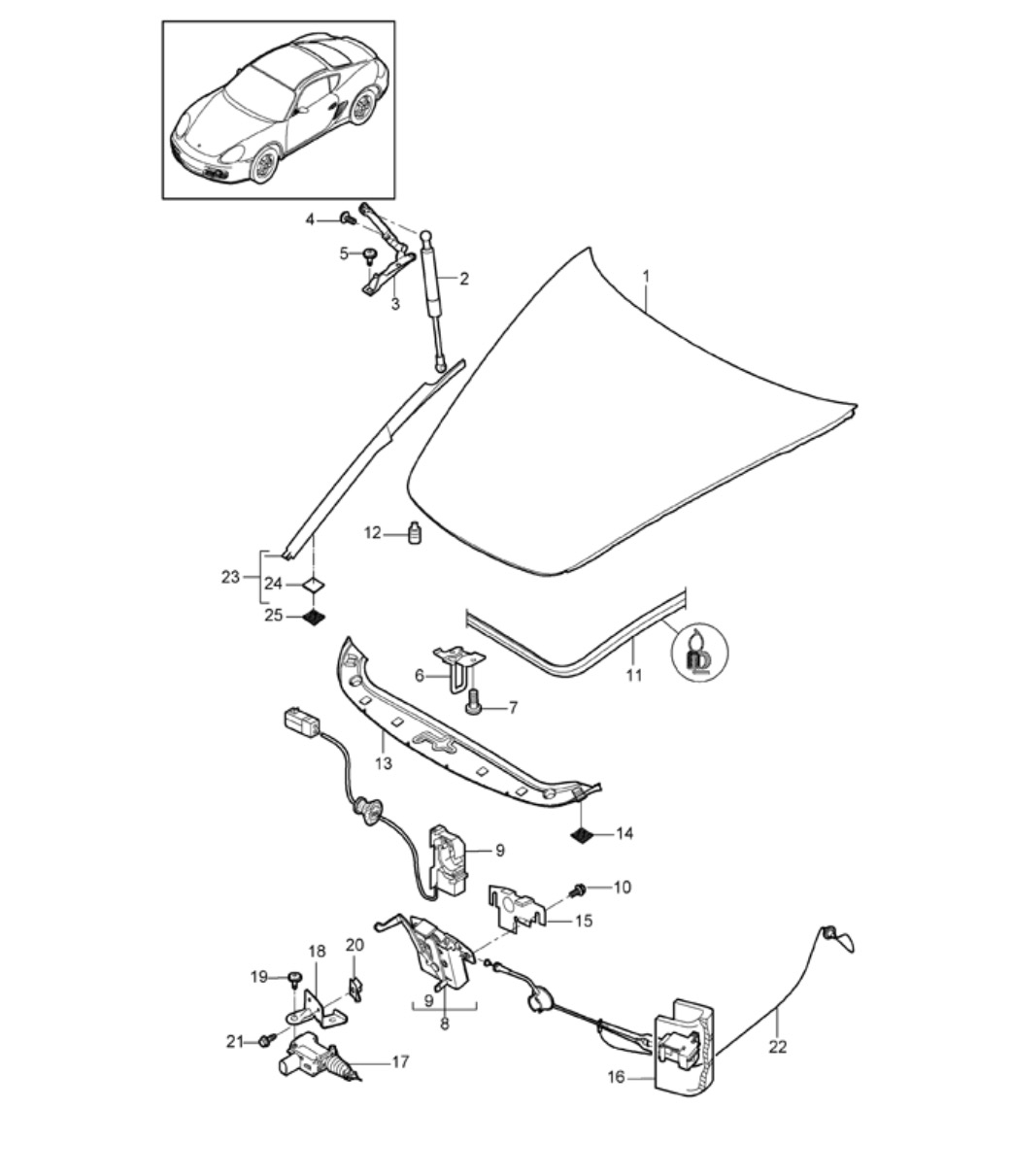

According to the parts cat it is a loop cable like the TT and it is located on the left side wheel swell..... Item #22
Name:	Screen Shot 2017-05-22 at 18.35.14.jpeg
