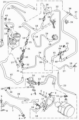

sound would be louder if higher pressures were expelled. sounds like either a leak or bov isn't holding the pressure. is it adjustable?
yes believe the bank 2 is for closed loop (idle and emissions) think most flashes turn it off somehow to abate CEL lights anyways.
it's possible some of the brittled hoses cracked when installing. Check the hoses around the F hose, in particular the ones that go off the orig DVs then T off and the one that runs around the lower F hose to the TB splitter. these are a series of white hard hoses connected to black rubber soft hoses. black rubber ones harden from heat.
