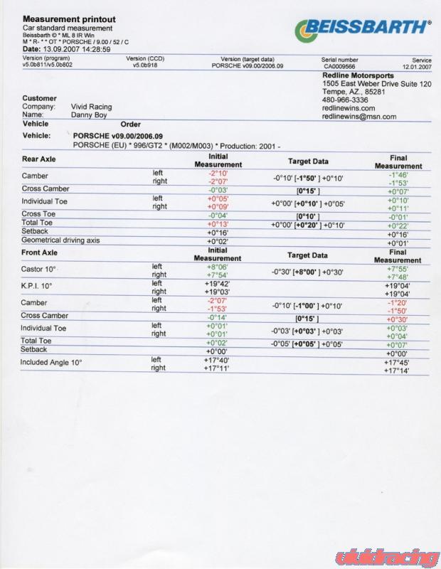

courtesy of vividracing:

Thank you for posting the measurements, but would they still apply for 19" HRE wheels & 315/25/19 tires?
