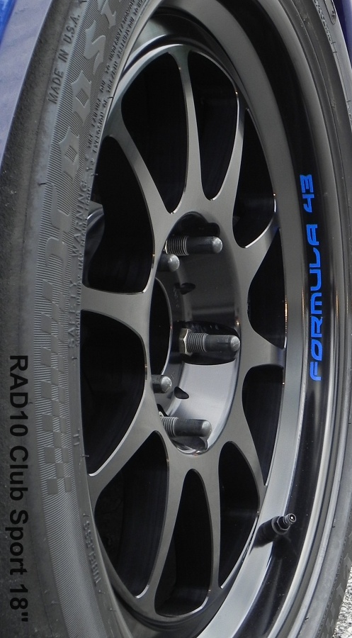

Contact Joe at Napleton Porsche, Westmont, IL. They design and make they're own bullet nose 14X1.5 stude for the Cayman Interseries cars. High quality steel and made in the USA. They also have the open end steel lug nuts as well. They're a little spendy, but again a high quality product with full certs.

Here's a pic of the studs.

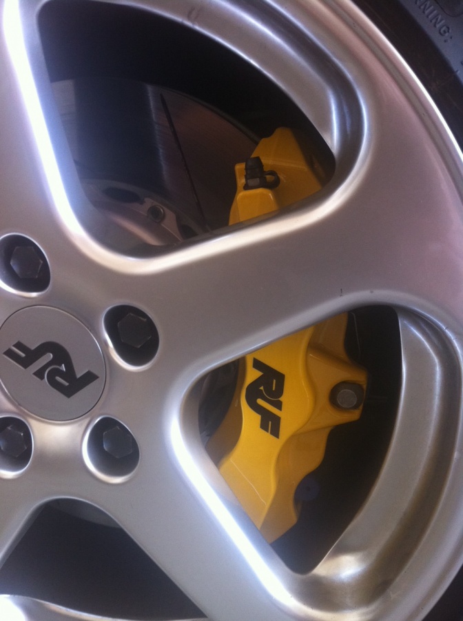

If you don't want the Darth Vader look of long studs then RUF makes a stud conversion kit the uses feather light black magnesium closed end lug nuts that makes the wheel face look very clean. The studs are not very long as they are 45mm total length with about 30mm sticking out past the brake hub face. The studs utilize a nice shoulder which makes the studs seat well against the hub face as you screw them in with red locktite using the 5mm hex opening in the stud tip. These studs are designed to be used without spacers as they are not long enough for spacers. RUF does make a 7mm hub centric spacer which comes with a set of longer studs. That's what I have on my Rturbo in the picture below. I've never had any issues with this kit.
