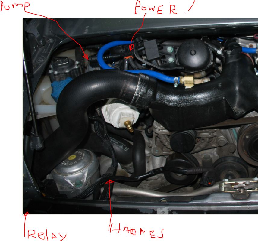

Where have ya'll installed your extra fuel pump? I was told it would have to go near the very back of the engine (close to the fan when the lid is closed) since I have a stock-style intake system (not the side intake piping like many of the high hsp cars are running).

Attach to fuel filter and hold together with hose clamp.

Bolted to the cross member under the transmission
What he said!

Originally Posted by tvurt
What he said!
Thanks for the picture!
Did ya'll custom fab your fuel lines? I think my mechanic said he would have to make them. Is there a place that sells the lines ready to install?

Originally Posted by bad107
Steve @ Driversource can easily make them for me, i was wondering if there were any already made that someone regularly sells (so I could save some $ on labor).
no there is not... we make them too...
you will not be able to directly connect it .. you need to weld permanently a fitting unless you have something like this...
unfortunately we cant sell them separately... and our kit works with our Y pipe only... you can buy a smaller filet I heard and make it fit though...
