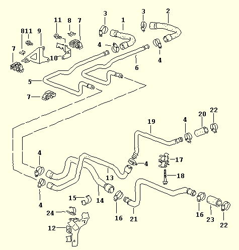

I figured I'd change the heater hoses (1,2,13,14 in attached diagram) while I was changing the clutch. Now that I'm ready to put them back together, I can't quite figure out how to route them. Does anyone have pics of the underside of the tunnel with the tranny out? There's only one way to attach the rubber hoses at the rear because they are different sizes, but hoses 1 & 2 are the same size at the front end. Also, can't see how/where they attach as they cross over from the left side to the right.
Any help would be appreciated.
Thanks,
Mike

hope this will helpName:  DSCF0821.JPG

TurboTodd: That's a big help. I see that they go forward before they go over to the right. Hope you didn't remove the tranny just to take the picture.
Thanks,
Mike
