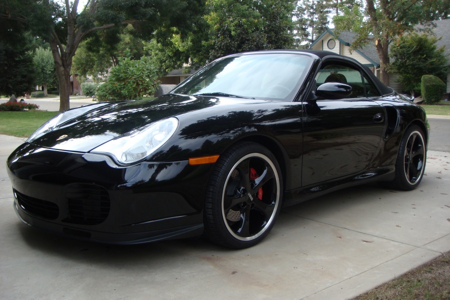

I have attached a few pics of the car with the new wheels. I do realize it is too high but doesn't look that bad if you ask me.
Thoughts?

The car doesn't look bad,mine looks the same,but when you get to install the springs it'll be a big difference.

Well it got the front down to a reasonable level. The main complaint about the 996 is that even parked it looks like it’s going uphill. The back is still a bit high but gives the car a nice raked look. This may also be a blessing in disguise. The rear eccentrics of the 996 do not give you enough camber or toe adjustment to deal with much lowering. If you went with coil overs and lowered it closer to GT2 height you would have had to also install rear adjustable upper control arms and adjustable toe links
