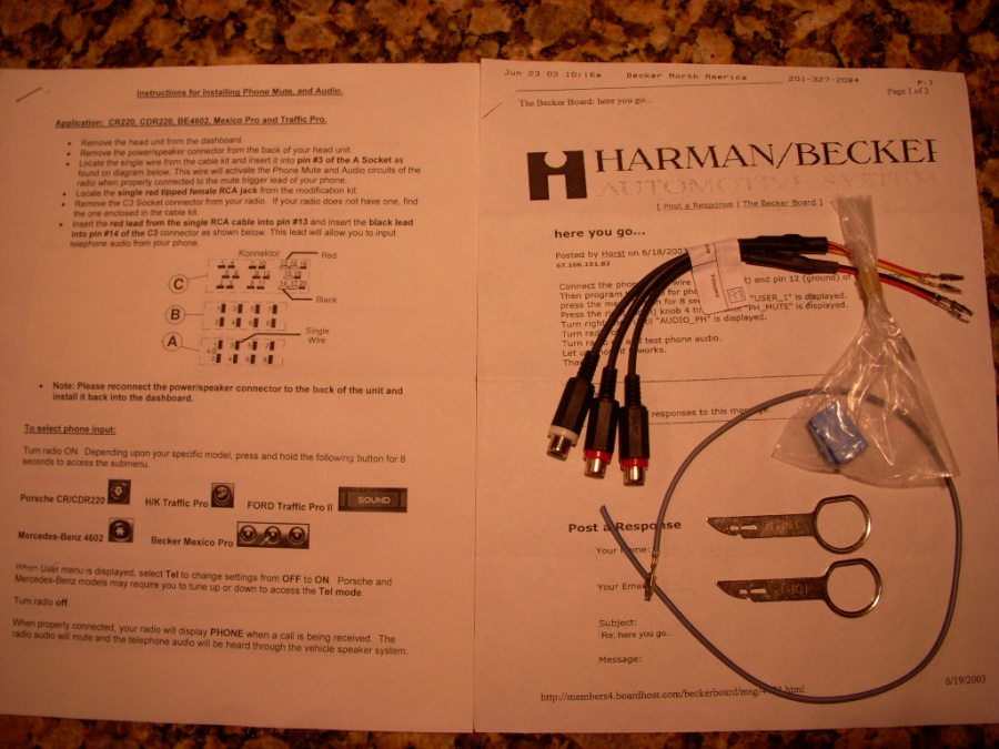

I bought this external radio MP3/phone wiring harness from Harman/Becker of North American back in 2003 to install in a MY 2002 Boxster S to run my ipod. I never got around to installing it as I sold the Boxster and purchased a 2003 TT, which has the newer PCM 2.0 MOST technology and does not support this harness. The harness is for CR220, CDR220, BE4602, Mexico Pro and Traffic Pro head units. The instructions state that it provides an auxiliary input that can be used for an MP3 or phone. Playback is heard through the headunit/speakers. If you're interested in it drop me a PM.
