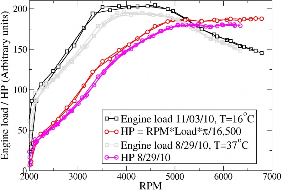

I collected some Durametric data back in August, when it was really hot. Collected some more today, when the air temps are a lot lower. The figure shows results for 4th gear pulls. Torque and hp are about 5% lower on the hot day.
Looks like intercoolers are in my future!
jon

jon, what IC's you running. what other stuff do you have on the car. Boost pressure? etc. did you measure AFR's and timing?
Dennis,
Sure, I measured all of that stuff. I'm one of Kevin's boys.
Stock 996 TT intercoolers, Milltek exhaust. Stage 2A (K16/997GT2)
The lambda's were about the same, 0.73 vs 0.74. Mass air flow is higher at the lower temperature (maxed at 1366). Boost is a bit higher too. Timing doesn't seem much different. IAT's were running up to 60C under boost back in August.
Jon
Jon
Interesting enough when I had the stge 2a, I switched from stock IC's to my B6's and I gained about 2 mph trap speed. And did not loose any speed over 2 hours of doing runs.
D
D
This makes sense... with stock intercoolers back in August, I was seeing IAT over 60C after a pull in fourth gear. Better intercoolers should decrease that and help top speed.

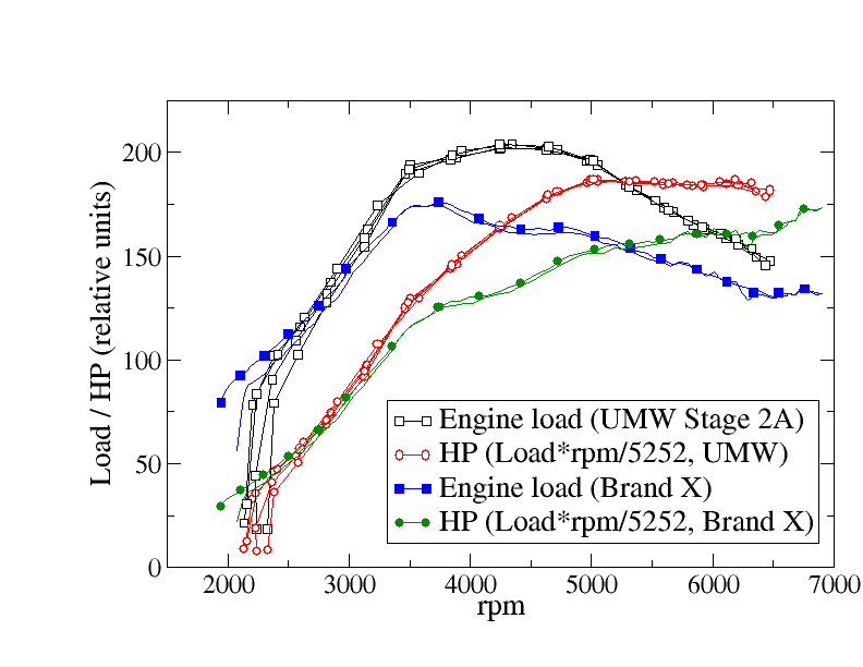

The highest boost in the data above was 1.24 bar. I've never seen 1.3, and don't really want to with my current configuration. There is more performance available from these turbos, but I don't have the fueling to get there with stock fuel pump, rails, and injectors.
Max boost and peak hp aren't very good indicators of performance. The load/hp-rpm curves tell you what your car is laying down. Someone sent me a Durametric data file from his car, which is shown below compared to mine. Note that the max hp is the same for both, but the curves from my car are higher over the entire usable rpm range.
IMHO, these curves are what people should be looking at when they compare tunes and turbos.
Jon
Jon
very good performance at this boost and temp....your AFR`s made with a 5bar FPR
Correct, I do have a 5 bar FPR.
Interesting side note... We had to detune a little back in April because the Injector duty cycles were getting to be too high (105% in some cases). Later discovered a leak in the fuel pump hose, and am now back to the original tune duty cycles max 90%.
