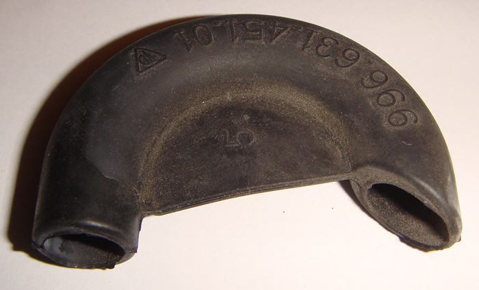

What is this - and why is it on my floor?
I just found this on the garage floor. I know it came from the car, but where should it be?
The car is still running great without it by the way...

I googled the part number and it appears to be a rear taillight vent tube. You will be fine, but next time you have your lights out, put it back in.

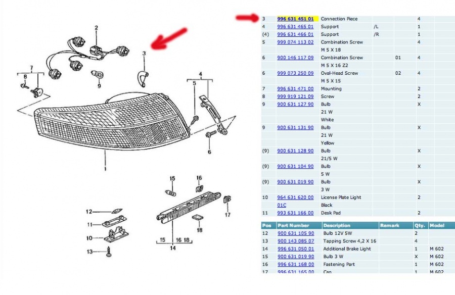

99663145101 $32.18$0.00$21.76Rear lamps - Combination lamps - Vent tube
Vent tube Back 1999 - 2005
Add to Cart Contact Us 99663145101 $32.18$0.00$21.76Rear lamps - Combination lamps - Socket
Socket Back 2001 - 2005
Add to Cart Contact Us OEM Catalog Item NumberMSRPCore PricePrice99663145101$32.18$0.00$21.76
SOCKET
yup >>>thats what it is!

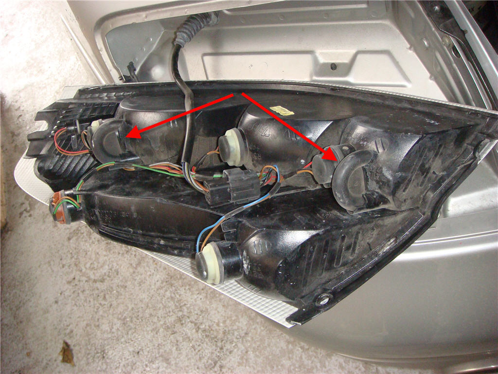

Here it is

Yes that's what it is alright. I had to replace one of my tail lights and I remember this tube. If you're worried about it at all you can reinstall it yourself very easily.

Great pics - but why does the parts list say you need 4 if there is only one per side???

Knudson Tube

Thanks for all those who posted information - I removed the light (naturally picked the side that was OK first) and found out why you need 4. I have replaced it and all spare parts have been accounted for again.
