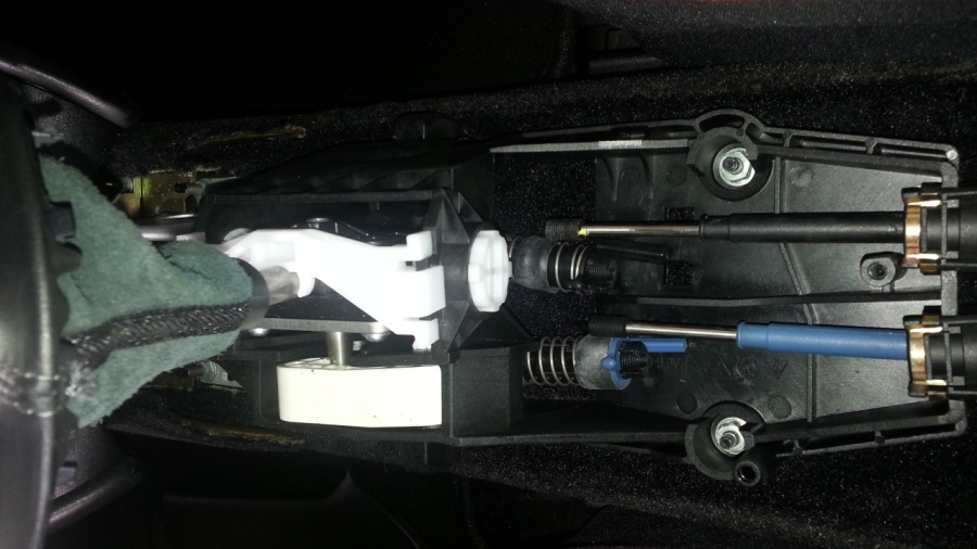

I'm having the same issue, except mine actually pops out of first once in a while when cold. It's almost like it's not going in to first all the way. I'm also getting a little grind once in a while going in to first. Did your problem go away? I'm going to readjust the cables today to see if that resolves the problem.

adjust the shifter cables
Adjusted using this tool.
do you have a part # for this tool? im getting a numeric shifter and will need to readjust everything when its installed

It's just a plastic alignment tool. It holds the shifter upright in neutral position while you put the cables back.
Part Number: 00072196190

I don't think the porsche adjustment tool will work with an aftermarket shifter
