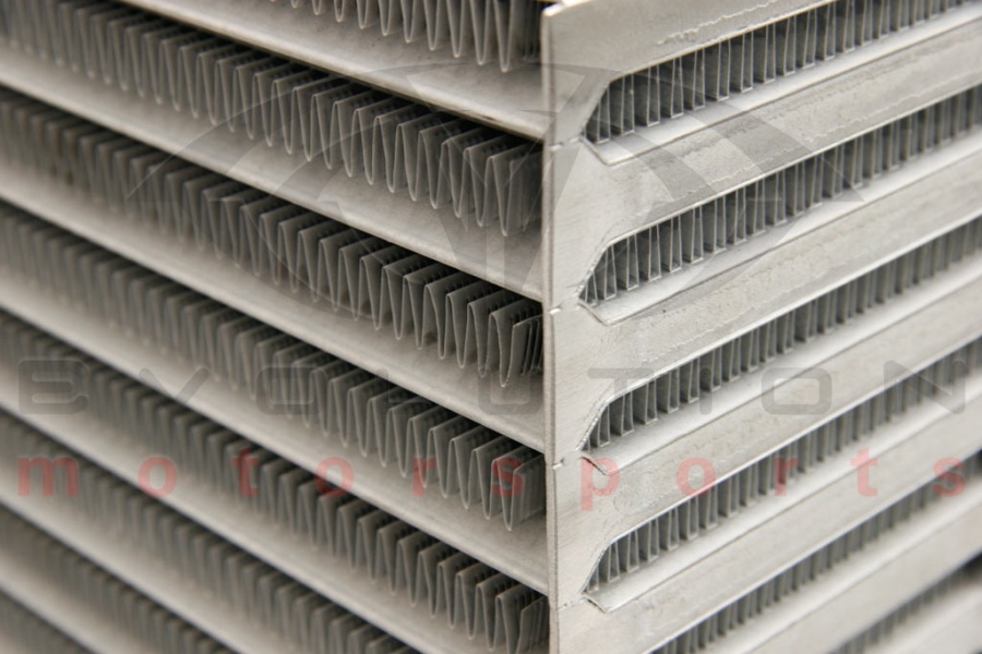

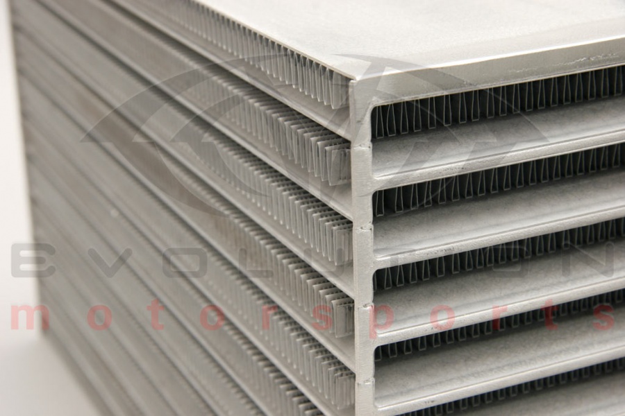

Originally Posted by joetwint
Evoms has a new core which happens to be terribly efficient on their 1300+whp997.I am not at liberty to say much more other than a set will be on my car soon and we will undoubtedly be able to tune my car more aggresively and still keep the motor in the safe zone.Maybe give Todd Z a call and he can fill u in.
Here are the cores that we are using on my 997.1TT. We have been testing this intercooler core for the past 1.5 years and it is BY FAR the most efficient core we have found. I have tested dozens of different cores from "aerospace" companies, Garrett and many others. Most of the efficiency was directly related to the design of the intercooler core and NOT the size of it. I will post the specific details about the design of these cores and what we found in terms of efficiency later. FWIW, these are 4.5" thick and support a REAL 1300+ Wheel HP
a tube n fin design that looks like its used to high pressure flow across the core, interesting.
