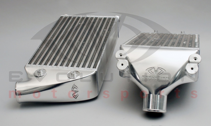

Originally Posted by Evolution MotorSports
Here are the cores that we are using on my 997.1TT. We have been testing this intercooler core for the past 1.5 years and it is BY FAR the most efficient core we have found. I have tested dozens of different cores from "aerospace" companies, Garrett and many others. Most of the efficiency was directly related to the design of the intercooler core and NOT the size of it. I will post the specific details about the design of these cores and what we found in terms of efficiency later. FWIW, these are 4.5" thick and support a REAL 1300+ Wheel HP
I am guessing this is Todd. Thanks for the information. What do your end tanks look like?
Chad, sorry I could not take your call yesterday. I will try you tomorrow. Here is a photo of our direct replacement intercoolers with end tanks. The end tanks that we use on the cores that I posted photos of (currently running on my 4.0L) are a modified version of these end tanks. Talk to you soon. Todd
