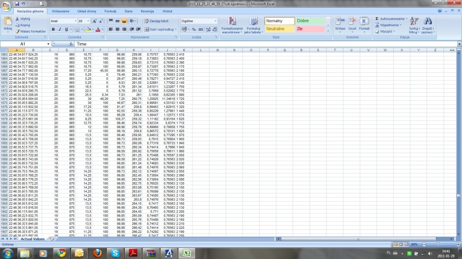

Guys, anything new here?
I can show my excel with some data but don't know how
ambient 2 C intake 2 C acceleration up to 275km/h and 20C intake temp.
what also was interesting in this excel...
at 259,97km/h I had 19C
at 260,13km/h I had 20C up to 260,34km/h (gear change)
than at 260,92km/h I had again 19C up to 275,31km/h
and again 20C

Karol, what intercoolers are you running?
I'm running liquid cooler system which I developed with in 2 years
but finally it look like it's working as hell
