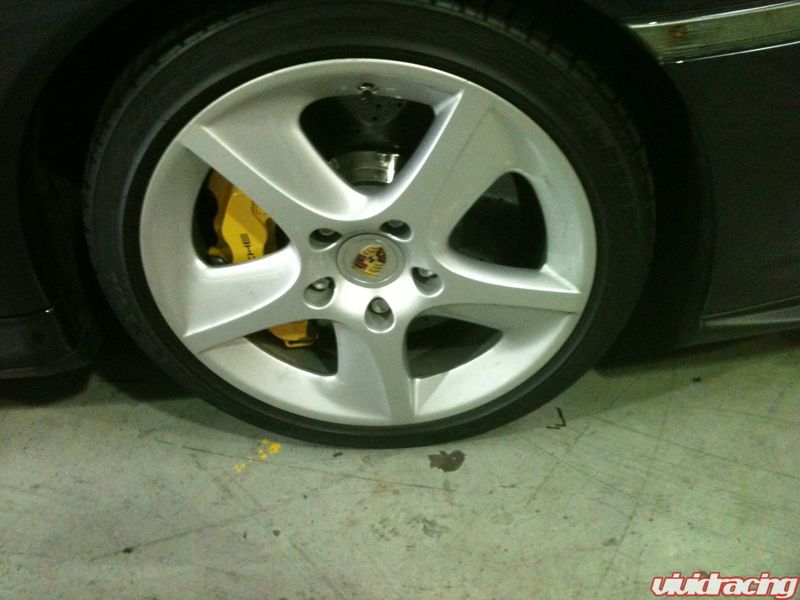

Just got this fresh untouched 996 Turbo X50 in from a used car dealer to perform a basic Stage II setup. This has a color (sorry iphone pics) that i have never seen before. It is kinda like a obisidian blue. Its almost blue grayish. Anyways the car has the big ceramic 350mm brakes, full carbon interior, and is in great condition.

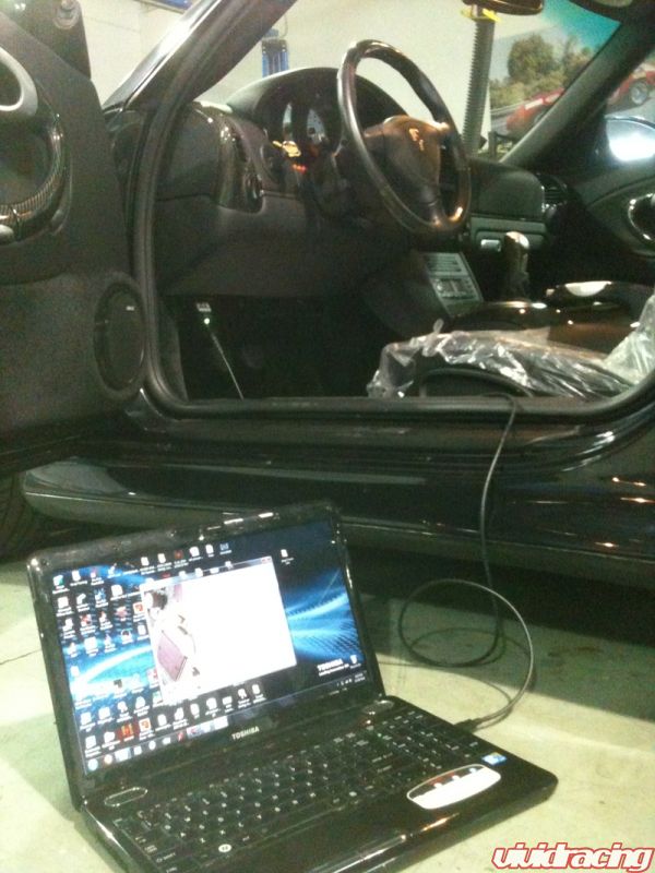

First step is our VR Tuned ECU Flash. As you all know, this is done via the OBDII port as seen here - www.vrtuned.com/installation. We have read out the car and tomorrow will do a baseline and then load the tuned file sent back to us.

Tuned and Original files received from Softronic. Expect some updates soon
