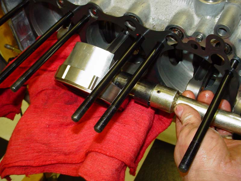

That part number is for the N/A motor. Those tools do not work on the tt motor. I only found the timing plates and tools needed to hold the cam's for the turbo motor on their site. You will still need the tools for the install of the cylinders
Thats a picture of the cam timing tool ....

yes sir that's it. You still need the piston ring retaining clip that lets you install the center piston.

Other tool needed are on these pics, piston circlip tool, cylinder press toll, piston ring tool, also the handle to move the cam can be useful.... Take a good look Tim and let us know!!!

Yes sir. Looks like the pics from IA site
Yes sir! I looked at it so often I memorized it to be ready for the big day
Def a lot more than what I got, I'll check everything tomorrow ... tks for the advice.
