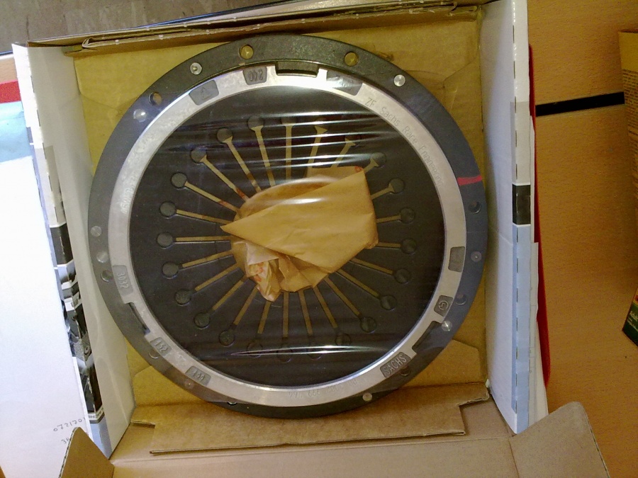

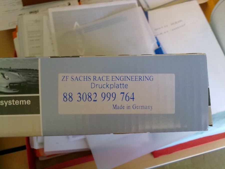

The clutch showed to my door today:
764 Sachs pressure plate

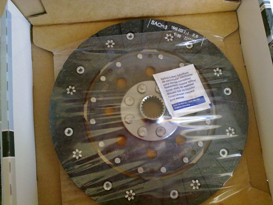

Special organic disc, that's supposed to work with an aluminum LWFW at a torque rating of 900+Nm
