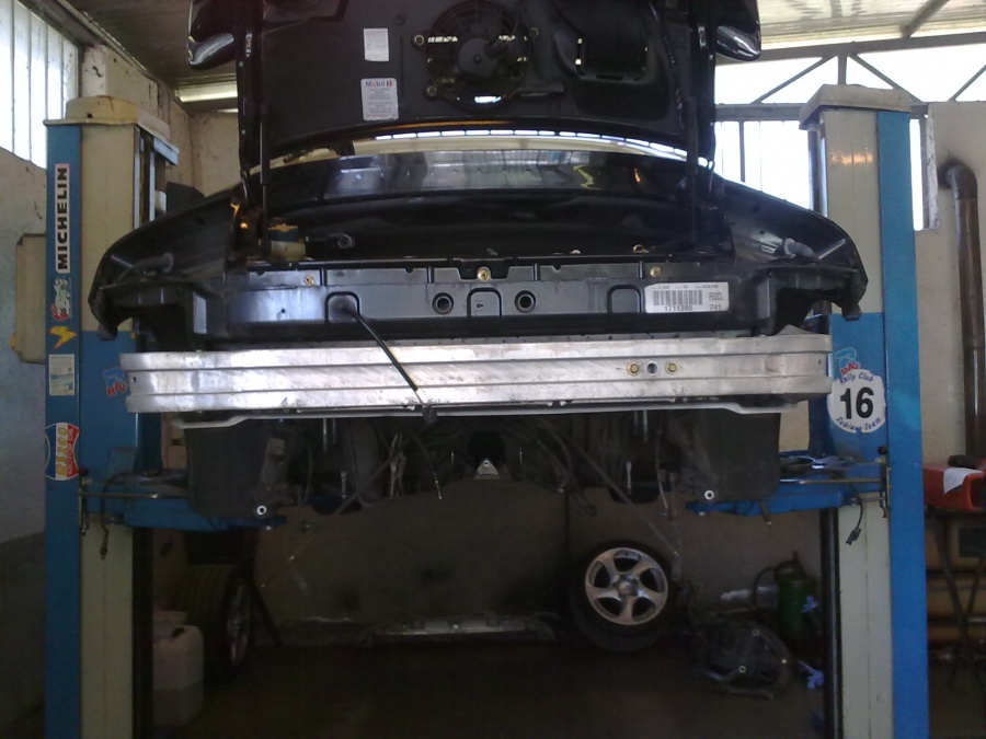

Stuck....thinking about dropping the engine or not..

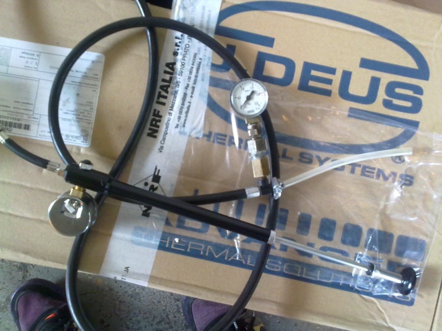

My wastegate adjusting tool LOL!!! It is actually a pump I use to adjust the bycicle pneumatic fork, only fitted with a pressure gauge that has a much lower scale.
Guys would you suggest dropping the engine?? It could take a bit, but in the end swapping the clutch, injectors, and inlet pipes could take less time...
What's your thought?
lowering the motor will def save you alot time...

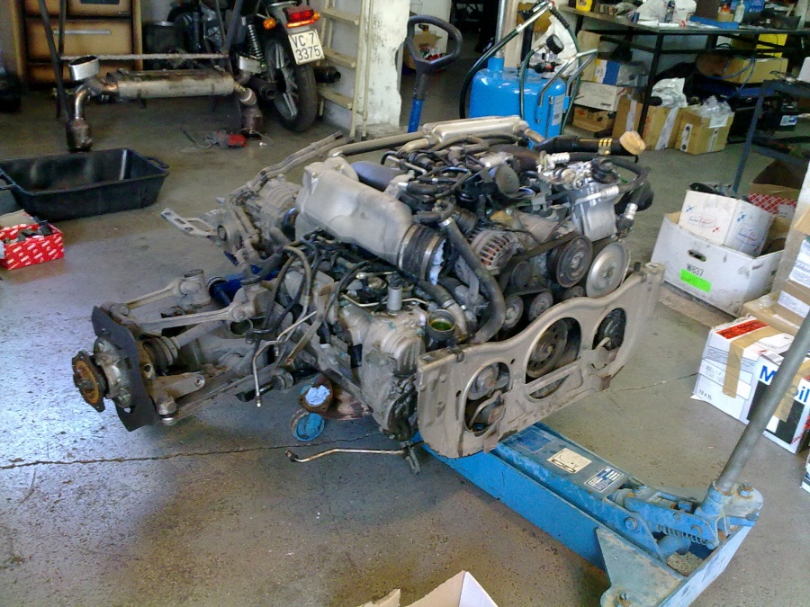

Engine out....moving fast now..
Attachment 150097
Attachment 150098
How hard was to take out the engine?
Good luck!
Well, it is actually pretty easy...easier than fighting with inaccessible items when it is on..

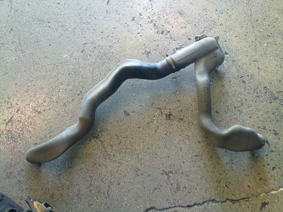

How many miles/km are on your engine? Now would be the time to check/change all hoses, clamps, coils etc. More pics of the current intake pipes compared to new ones please, thanks for the pics and updates
60k...I have new plugs, coils, belt, tensioners, a bunch of hoses, filters and other "service" stuff. I have to say hoses, clamps etc. look pretty good even if they are 10 years old..
I'll post pics of the old intake, which is horrible to say the least....they should fire the idiot that designed that piece of $hit...

How twisted has to be the mind of the tech that designed this thing??LOL!!

These intakes must have been either an afterthought or more likely a clever design to limit power for the next model for which the 997tt is much better. Good luck with your interesting project.

Attachment 150122
Careful boy.......that's the way we,scientific,develop products
