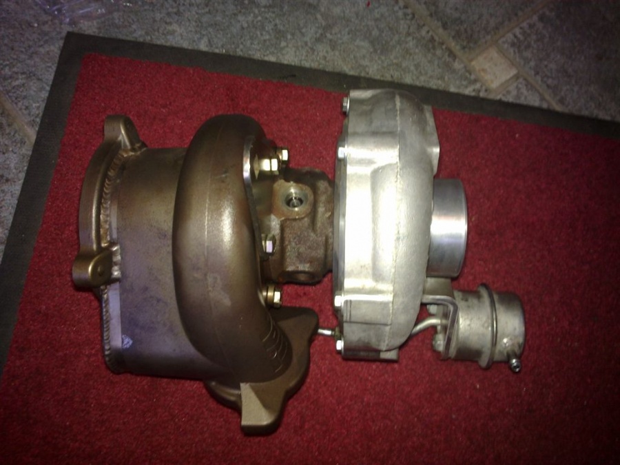

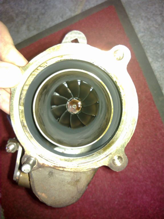

Cool Soooo...a pair of Tial 3071 showed to my door today!
Used set (7000km approximately).
I'm saving to buy IC's, intake piping, fueling stuff and a clutch.
I will use this thread as a "diary" of my modding journey, and I will update it every time I got something new.
Well, for now I only have turbos...
