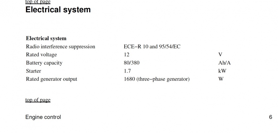

According to the repair manual (see pic) the output of the generator should be 1680 watts. To convert watts to amps you have to divide by 12 volts: 1680 / 12 : 140 amps.... Thats should be the minimum...
