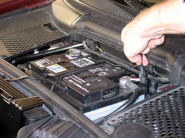

Thanks guys...is the battery hard to get too because i have the front open but dont wanna start tearing too much apart just yet...
Not at all. Just in the center of the car, in front of the windshield, you got a plastic panel with two wing screw. Just turn these wing screw together 1/4 turn and lift the complete plastic cover. The battery is under.
Isn't the 05 C4S a 996? If so, the engine compartment does have some terminals to jump start/charge. However it really doesn't matter if it's a 996 or 997, battery is in the same place in both and easy to get to. Maybe you should get an owner's manual and check it out.
