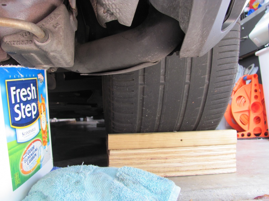

I have H&R springs with Champion 19's running 295/30/19 in the rear. I have some neg camber (not sure of the specs as previous owner did the suspension and alignment) and pretty even wear across the tire. In fact the centers show the most wear. I'm moving up to 315/25/19 as I have been told I have the wrong combo (235/35 and 295/30).
I'm not sure what other suspension components were installed with the springs, but what should I expect with the 315/25 as compared to my current setup?
i was concerned that I would need toe links as well, but considering the even wear I dont really want to touch anything.

If you have satisfactory tire wear and are happy with the handling, don't change anything and don't get talked into buying stuff you dont need.
