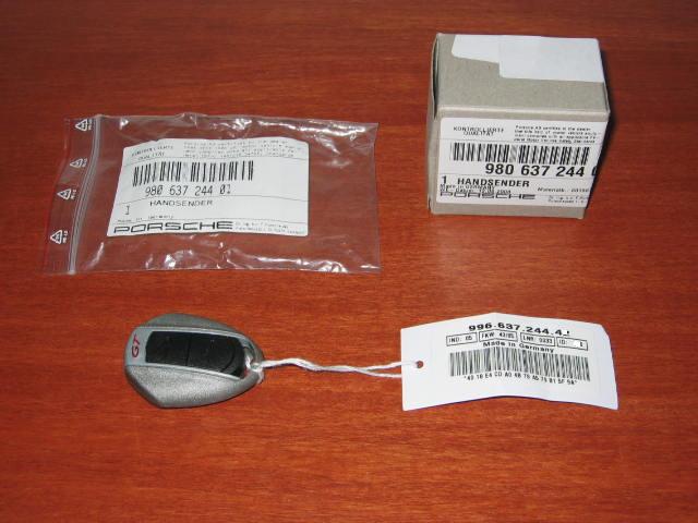

I bought a GT head from sunset and it came with the tag !
Mine came with the tag !
see picture..
see picture..
Perfect- very helpful.
To update everyone- Sunset is ordering another key for me- hopefully this one comes with the tag...
