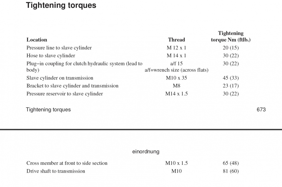

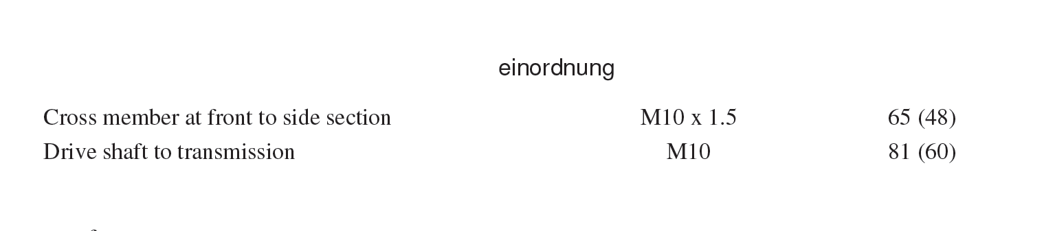

60 ftlb or 81 nm. Apply proper torque. It is really important. And also used a good calibrated torque wrench. I had a bad experience with that one

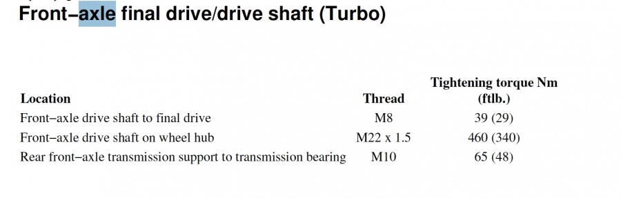

Yes I am. Take a look at this picture from the repair manual...Last item... We are talking about 8 mm allen bolts not torx....

The torque I mention are for the rear half shaft bolts which are 10 X 65 mm (8 of them) . Oh my god I'm sorry just realized you were asking for the front...Good thing you were more awake than I was... Sorry again. The front (6) are 8 X 50 mm and the torque is 29 ftlb as seen on the pic.
