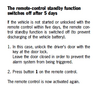

2) When I let the car set for several days the keyless entry (pushing the open/lock button on the key) will not work. I have to insert the key in the door to unlock the car. After I start the car the keyless entry works fine to lock and unlock the car. Could this be related to the bad door open/closed sensor (window doesnt drop 1/4 inch and stay down until door closed, another problem I need to fix)?

On #2, your car is probably going into "battery saving" mode. I believe it's after 5 days, you have to use a key to open the doors. Check the manual -- but I think it's normal.

Second question: Normal: see capture of owners manual:
