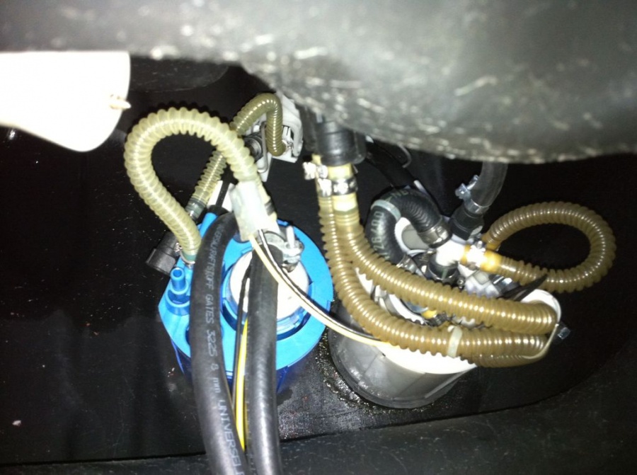

In my opinion the only safe way to run dual pumps is to separate the left and right side of the engine fuel wise, then you let one pump support the left bank and one the right side.
I have done this on my car and it's quiet simple, you buy a fuel rail for the right side (this is where the FPR is located) and fit on the left side (it bolts right on). Then you route two new fuel lines, one return and feed line. If you have the GT2 tank like i do then you have two access holes= two output holes, so I just added the fuel lines from the GT2 (I have a Turbo with GT2 tank)
I post a picture of the fuel pumps later.

are you monitoring somehow that both fuel pumps are working? so you dont try to run the car with only 1 pump working?

No, the beauty of it is that if one pump stops running it won't hurt your engine.
Well if you need 2 pumps and one goes out, then your car will run lean since 1 pump isnt anuff that why you are running 2.
NO, if you have separated the left and right engine bank and one pump stops one half of the engine will just stop running.

Here is a picture of the pump installation
