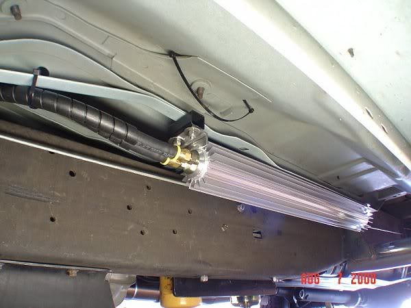

I have ordered up a fuel cooler normally found on a diesel truck. This is the longest I could find. Hopefully it will fit in the tunnel next to the d-shaft. They make a single pass -6AN in/out. This "should" do the trick I hope. Will keep ya posted. Best part it was only $75! No p-tax

Do you have the same fuel system as me? Is Alex installing the fuel cooler for you?

Yea, pretty much the same thing. I havent talked to Alex about it yet. I will probably throw it in myself.
