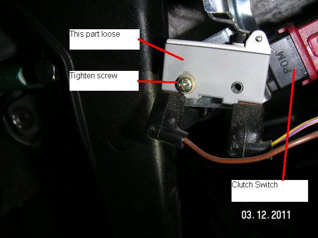

I found one of the switch or relay next to the clutch pedal that the screw holding in place was lose (not the electrical connector). I tighten the screw and no more starting problem. Perhaps, the screw was also acting like a ground so when not tighten, lost the ground connection. See pic for the part I am referring to.

Excellent! Thanks for sharing the solution.
