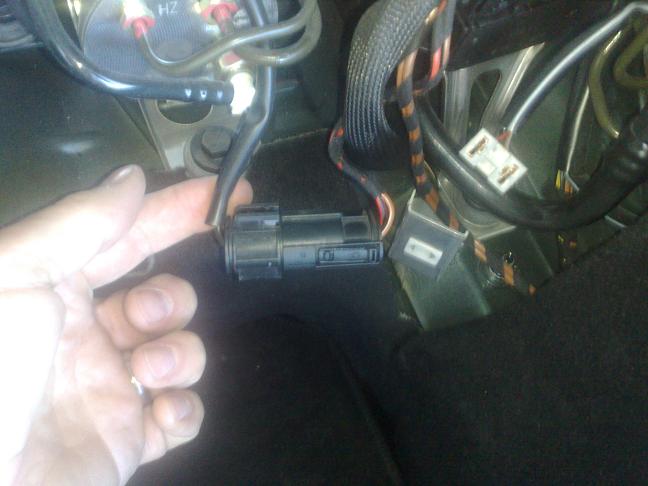

Can't you turn if off by unplugging it

Guys...
You must do these 3 steps:
- Unplug the PSM
- Install LSD
- Enjoy great driveability and great lap times!
No matter whether it's AWD or RWD 996 Turbo.

when you disconnect that plug you also lose ABS I am told by my shop ?
Your shop is wrong. When you disconnect the connector to the precharge pump you disconnect PSM and retain ABS
Great I know what I am doing today
