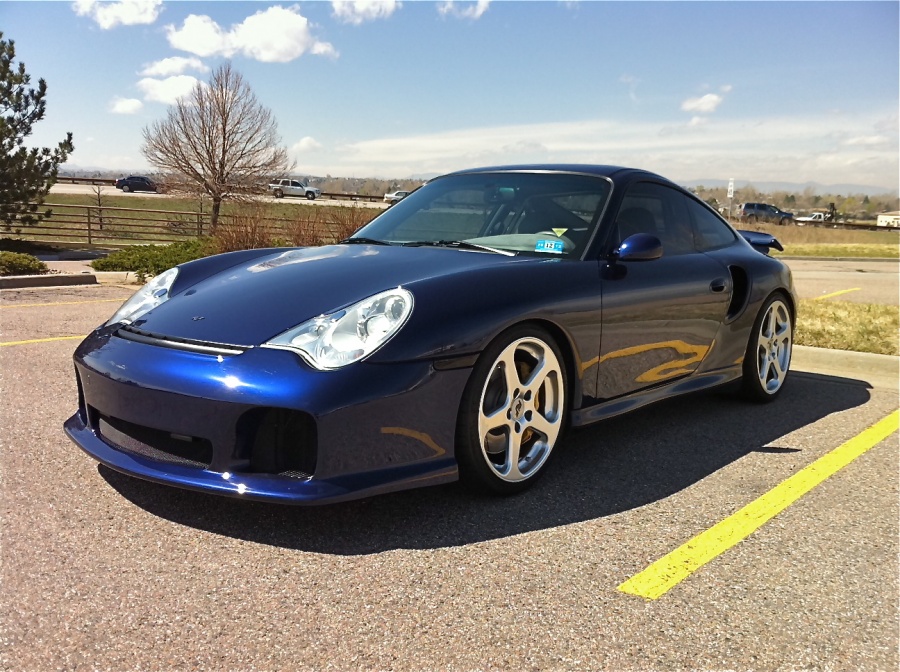

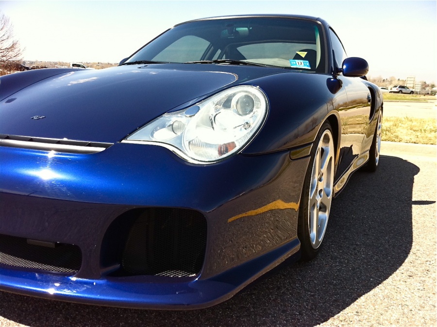

Based on the clearance I have on a lowered set up (25.25" to the fender in the front) on a 19x8.5 et 50 with 235/35/19 PS2, when I'm at full turn (full steering wheel deflection) the edge of the tire gets REAL close to touching the fender liner. Any more aggressive and I think it would hit. My opinion is that et 41 will rub in a tight turn. You can see the et50/35 offset on 19x8.5/11 in the attached pictures. This set up does not rub in any situation on 235/35 and 315/25 tires.
