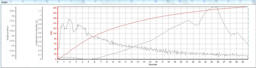

100-200 was 5,74 and 200-300kph was 13.13, 100-320 was 18.20, 100-330 was 21.27
Of course you can go faster between 100-200 and 200-300 on dedicated runs. And I wasn't driving the car. The editor of the magazine was over 1 sec slower to 160kph that me on the day.
Here is the graph from that day.

On my 20g setup at 1.44 bar my 0-300kph time was 21.45 Looks like these setups run fairly consistently.

@996ttalot
Ok you talk about performance and the performance of your car is great!
But: in the artikle you talk also about hp an with this 100-200 and 200-300 times I cant believe that your car has 800hp!
My car (996 Gt2) had 640hp on the crank and maybe with better conditions of the fans it can get 700Ps and my personal best was 5,2 sec. 100-200 km/h...
i run 1,4bar of max. boost!

As I was saying here in lie the issue with hp.
However, several points
1) The car is a tiptronic so crank hp to whp is approx 25-25% loss, not the same as manual which is around 12-15%.
2) The numbers on that day was on an incline of 1.37%, not your normal 2-2.99% decline that everyone runs
3) The car weighed with driver and fuel on the day @ 1690kg - a lot more weight than yours I would guess
4) I have beaten your personal best time many times when just trying to perform a 100-200kph time.
The fact that it beat the Veyron from 150-200mph shows the strength.
Finally and probably a better proof of hp would be the 139.6mph @ 10.8 seconds with 1660kg weight. I would say that is pretty close to 800hp.

One last point - if you look at the 9ff r1000 which runs 17 seconds 0-300kph, it actually takes 8.4 seconds to run the first 160kph.
100-200kph is too short an increment to measure hp. However clearly it is a measure that you can compare cars by, just like 60-130. But you can have a car that is slower 100-200 and yet have more hp.

I have a programm that corrects incline or decline so it dosnt matter
Do you have a *.dbn file of some of your runs that were better than 5,19 from 100 to 200?
I was driving 4th gear only for this run
Those very good results on tip car with pumpgas
Have u ever think to try MS109 or C16?
Ur car ran right now ran almost as quick as tip 997tt w/modded vtgs on racegas or meth/pumpgas mix which should around 640whp
